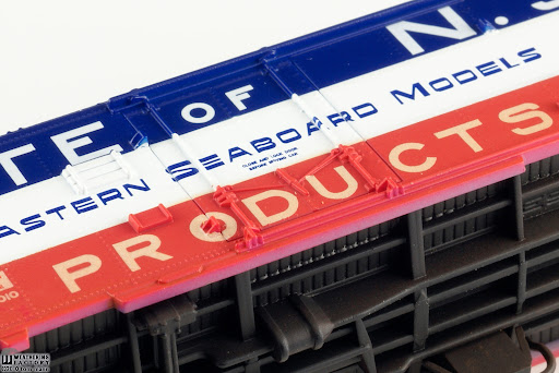

Let's weather this car over the next week or so. I'll post in-progress photos. ;D

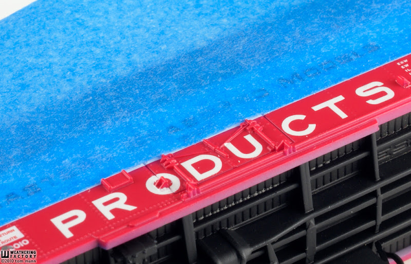

Since we don't want the red to fade to a pink color as it would if we applied a global fade coat (I'm condensing here), mask it off:
and airbrush a coat of Polly Scale Zinc Oxide Primer:

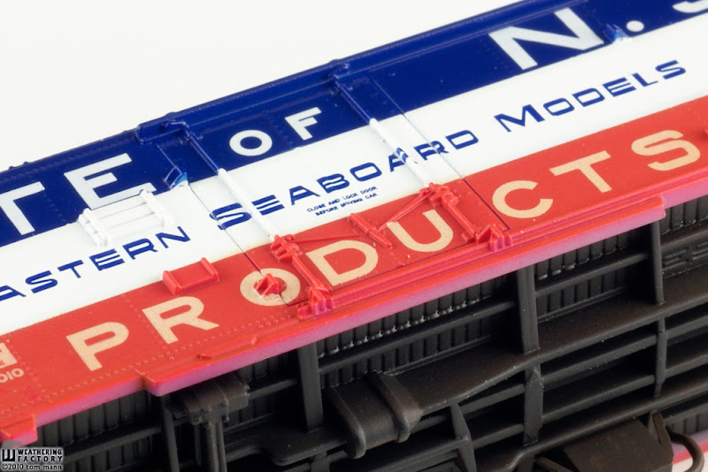

When this dries, mask off the red and apply a Polly Scale Aged White fade coat to the blue. There are a few photos of this car (or at least this scheme) online, and some show that the blue faded into a very blotchy, circular appearance. I chose a more subtle approach.
Note how significantly I had to fade the paint to get to the point where I wanted it.

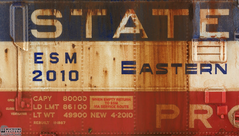

Not finished, but a preview of what we'll cover the next few nights: streaks and rust bubbles. Note the areas we can clean up a little bit.

Ummm, it says new 4/2010 but has a rebuilt date of 1987. Tom, do something about that!
