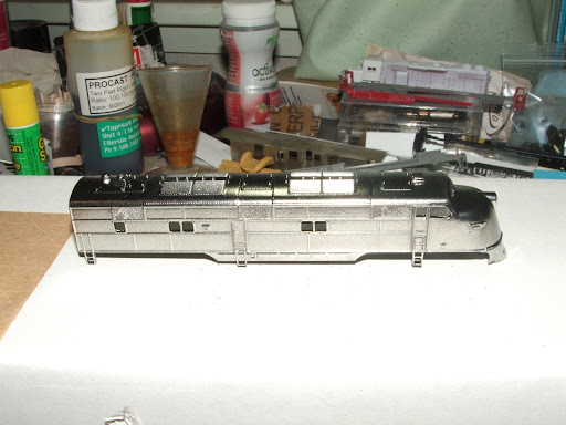

Re: Painting Stainless Steel Passenger Cars
« Reply #16 on: September 12, 2010, 03:28:23 AM »
I'm another advocate of Alclad. The picture of the E3 has Alclad2 Stainless Steel shot over gloss black. It looks better in person.
