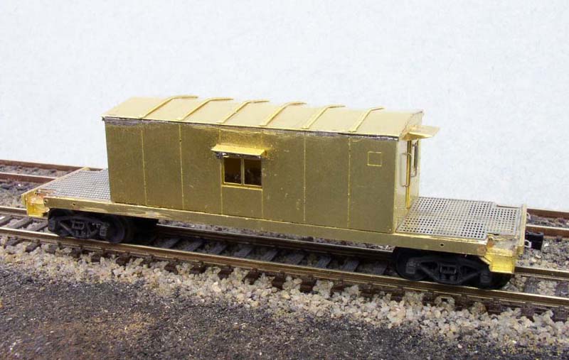

Well, what drove me to this post was Bob Knight's (TrainCat)'s EXQUISITE brass NYC/PC/CR N9 transfer caboose kit.
It's all etched brass, typical high-quality etchings.  One thing I've learned with most kits is that rule that 'if the only tool you have is a hammer, every problem looks like a nail'.   If it's a metal kit, it's all metal, even those things that probably shouldn't be metal - same rule holds for plastic and wood.   For instance - the frame - is all etched pieces - two girders, crossbearers, crossbearer caps, bolster tops.... wow.   The frame build alone was like 30 pieces and you can't see any of it.  Directions say that you can use thick ACC, but even the remote potential of derailing/dropping the finished kit made me decide to solder up as much of it as I possibly could for strength.
Really got all the way through the body and it was difficult but not frustrating.   http://www.randgust.com/CRN9E01.jpg
Then I got into the rails, which on an N9 are the distinctive features.   OMG.   You've got .008 phosphor bronze wire (upper and middle) going into STAINLESS etched stanchions with .009 holes etched in them.   If you follow the directions you rapidly find out there's not quite enough wire supplied.   You have to fold each stanchion on itself to come up with a .010 thick assembly - like 20 of them - and then thread both wires through two holes on every stanchion.   Then, after all that, you try to ACC the six rail assemblies to the deck - no soldering here because they are stainless.   The base of the stanchion is a folded-back tab section about .040 x .040 - that's all that holds it.    Folding the stanchions over with tweezers wants to make them fly across the room, and once threaded onto the handrail wires (that are basically springs) also wants to fling them around the room as well - spent more time than I care to admit on the floor searching for a non-magnetic stanchion.  I have two rail assemblies done...but nerve-wracking is an understatement - a solid 10.0 on my degree of difficulty.  I'll go back to several evenings of windshield wipers and lift rings for relaxation after this one.
I think that in this case, stainless was a mistake because brass could have been soldered to the deck for strength - these want to break loose at the slightest shock load using ACC.   The other inexplicable things are mention of a etched wood deck for the N9A version that apparently isn't furnished (but don't need but is shown on instructions) and a nice big etched hole in the roof but no furnished smokejack and nothing mentioned in the instructions.  The brake wheel and stand is...three etched pieces, a mounting wire, and a two-piece-layer stainless wheel that has to be aligned by the spokes.  Also cast parts supplied for the brake reservoir, etc. but no indication of where they go - just on the underbody.  And some big etched piece with tabs on it that has no apparent purpose at all, and end roof pieces that ARE necessary but aren't mentioned in the instructions anywhere.  Again, 10.0.   I think I can, I think I can...   I'll have to come up with my own extra details for the propane tanks.
It will be a great model for sure.... everything is dead scale size .... but I have to keep walking away from it because I find myself holding my breath so long I'm getting headaches!
I also thought that using stainless steel for delicate parts was a mistake due to inability to solder SS. But then I managed to tin and solder the railings of TrainCat's AutoRamp.  I used TIX liquid flux (Zinc Chloride) and turned down the soldering iron's temperatures way down (I usually have it set to 700 deg. F).  My failed attempts were using the hotter iron. I'm not sure why I thought about lowering the iron's temperature.
First I abraded the SS surface using an abrasive disk in a Dremel too. That removed the oxide coating from the surface.  Then I dabbed some flux on that surface and touched it with a tip of the soldering iron which had some solder deposited on it. That easily tinned the the stainless steel.  I was really surprised and very pleased that it worked. I was then able to solder the railings to the brass part of the model and the joint is quite strong.  See the construction thread here.  I again failed to make notes about the procedure, so I don't recall the specific temperature and which solder )Tix, 60/40 or silver-bearing) I used.  I'm bad that way :(
