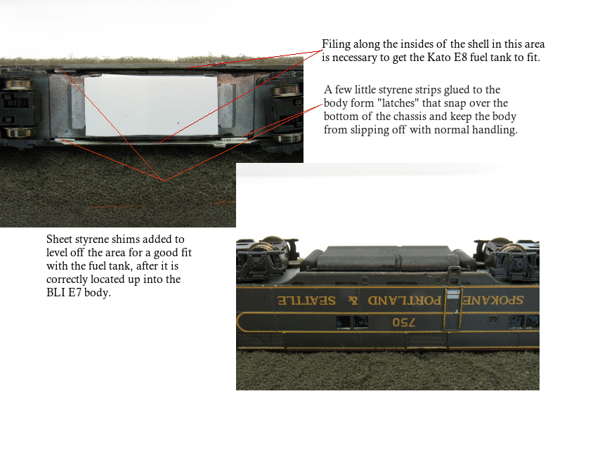

I did make a minor adjustment after shooting those photos.
For one, the fuel tank was getting a little fussy about coming loose under
the frame, so I drilled a couple of 00-90 holes into it underneath, and put in counter-sunk 00-90 screws.
I also replaced most of the grabs I added on the left side up and over the nose.
They looked nice, but they are "ladder" grabs with the fancy bar shape to hold a ladder in place.
I knew they weren't quite right, but the BLMA detail fret didn't have any plain ones that were quite
the right length.  I have since replaced them with some from a GMM sheet, except for
the one up on the corner, which is supposed to be a ladder grab.
Finally, I added the ladded grab on the opposite nose corner, and put some MU hoses onto the left side
of the pilot.
