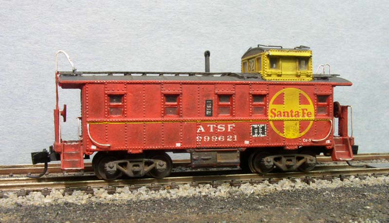

I'm glad you guys are having fun with this, and Bob, that's one impressive UP hack.
I'd put wire smokejack supports on my previous Trix builds and decided they just weren't visible enough to bother with on this.   I'll take closeup photos because I can, but if you go back to my first post, ... this is intended to be an operating, not a display, model.  So not only will it be equipped with the best operating features I can find, it will also have a custom lighting package..    I'm a whole lot more concerned with how well the lighting works, the couplers work, and will stand up to pushing 25 cars without derailing than rivet sizes, or even roof profile.  It's a pickup, not a show car.
By the way, has any "Santa Fe" caboose EVER been made with the right peaked roof for certain classes?  I know Bob Knight was working on one in brass before the Centralia model came out, and once it came out, he shut down the project.  The Trainman caboose is round-roofed and also has the wrong-wheelbase frame; the only stock cars that have the trucks where they belong are the Trix and the IM/Centralia.  The various AHM/Bachmann cabooses are a CN-style hack, other than cupola position and wheelbase nothing else is close.  I've been through Spook's database and if it's in there, I sure don't see it.
Focusing back on what matters to me... post-paint testing revealed several flaws.  The 'new' MT2004 couplers just don't work right.  They're a lot bigger than the older knuckles, size doesn't bug me (although they are just too big) but they don't open on uncoupling magnets properly and thow over to delay... they consistently hang.  So off they went, replaced with conventional body mounts, even though those run low, but they work.  Those worked great, switched all last night with it and it's pretty flawless....almost.   If I can work these as they should be worked - absolutely not touching the layout and working the entire local using magnets and delay, that's the 'pass' test here.    Picks are for guitars, I don't even own one; reaching into the layout is an invitation to destroy something like light poles or other detail.   Oh, and I like Z's, use them on all my small steam.  Just not here, the magnetic performance is too erratic.
That led to problem #2, those couplers have the worst 'slinky' problem of any of them, and this is now one free-rolling car.  Too free-rolling, it had to come off again and have a drag spring put in it on one axle.   That's better.
The lighting package on this thing is just phenomenal and as much fun as anything.   Remember I'm DC; so it's polarity-sensitive on direction, with an integrated circuit and a medium-sized capacitor on a board that is the full length of the inside of the caboose.   There are two red marker LED's under the roof ends, so that the LED is lit on whatever end of the car is trailing at the time.   Those are surface-mounted LED's in scratchbuilt housings.    And there are four surface-mounted LED's for interior car lighting as well.   Works great, but if you could see through the windows all you could see is solid electronics.  When I studied my first photos I realized what looks like a lens is actually one of the power wires to the board behind it.
As the power comes up the proper LED powers up before the train even moves, and stays on, no flicker.   The car lights come on about the same time the train moves.   When you shut the power off, the LED stays lit the last direction the car moved for quite a while; we're talking about a minute.   If you hit the reversing switch, the LED that was lit dims out and goes dark as the opposite LED comes on.    Jim's done the Intermountain lighting packages as a stock item, but he hadn't done this tweak before, a bit of an experiment and a successful one.  Substitute white LED's in conventional markers and this could work for non-ATSF applications.
Jim wanted me to make some YouTube videos of the lighting, I'm working on it.
The principle of diminishing returns is alive and well with this one, tuning if for performance subjects it to more detail abuse, already knocked off one of the end ladders, having to retouch some paint, etc., etc.  Time to stop.   It's a lot easier to tinker with the Intermountains just riding along on the ends of trains, I don't expect them to perform like this one has to in constant switching service.  It's a LOT more reliable that the Trix rebuild it replaced, and now I'm down to only two remaining cabooses that remain to be replaced and upgraded.

Randy, I think you got the screened window look just about perfect.    Nice lit up lights too.  Too bad that circuit board won't work on DCC since I converted over four years ago.
No magnets on my layout any more.  Rix Pix are da bomb.  However, back when I was experimenting with it, I got good result from MT Z scale couplers by bending the dongle down so it's got a straight section for a while then it curves closer to the track.  That worked as well as the stock N-scale dongles for me.
I agree that truly scale (.0015") braces are too small to be seen.  That's why I went with the .003" suture silk...it's both durable and visible.
Some roads only turned the lights on at night.  The 1950's UP was one of 'em, and so during the day, the lanterns were mounted on the rear, but they weren't lit.  For my prototype, MV lenses work just right since I don't  do night time ops.  My son, on the other hand, is a rabid SP freak, so I think it'd work well for his cabooses if it were DCC compatible.
However, for your ops and road, it's pretty cool what you've done!  Kudos to you.

OK, so....
1)  It's a bumblebee, it's not supposed to fly, but it does, the 1023's are working just fine. That's why I'd put 2004's on to begin with (read the thread).  I was skeptical, but 'road trials' proved it wrong.  Nothing messes up theory like test results.  I was astounded when even the electromagnet couldn't yank a 2004 coupled to 1001 apart, just sat there under slack.  Head is too fat on the new 2004's.  1023's are already modified on the heads for RDA.  I may shim up the back of the box so that the heads don't droop, but as long as it's working.....it's at the risk of beating up the paint and detail one more time.
2)  Retarder springs are on it already, read the thread.  Yep, was a problem.
3)  ATSF at least ran the red markers all the time in the 70's  and Gulash videos show it, but it's a lot more focused beam.  It's so focused that if the caboose is bouncing around a bit it looks like it is flashing.
4)  That Life-Like car is interesting, definitely better rivets, right wheelbase, still round-roof... My 2000-class car is still a shell, not far enough along that I wouldn't go back and try one - thanks!  This car, right?  http://www.spookshow.net/freight/llchinastandard8.html
5)  Screens are already in, see the photo (and you can see the red glow in the night shot on the lower sashes)   As Krystal-Kleer comes out without much damage, I may still try something else, but its about where I want it for now.  The color and opacity is right, it's that 'flush' mount on the lower sash that remains on whether or not that's enough to actually bug me.  That's the tinted Krystal-Kleer.
6)  Look at the photo of the Life-Like one vs. the Bachmann one on the window patterns on both sides.  They paint it up like a Ce-3 (even the right car number) but it's another derivative; Spookshow says CN and I'll agree with that.  http://www.spookshow.net/freight/bachstandard6.html    I may not care about rivets, but the wrong number and location of windows are even where I draw the line!
