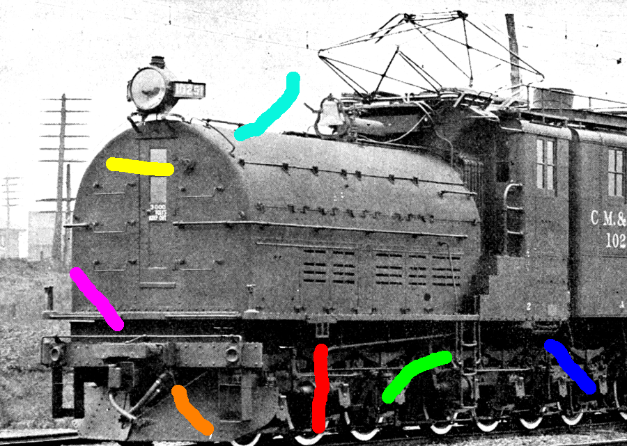

Time for jacking pads.
Let's refresh what they look like.
Marked in red.

Turning to the other side, I installed the jacking pad there on the right side.
I must confess, this is not easy.  But this is also a case where the final result justifies the effort.
