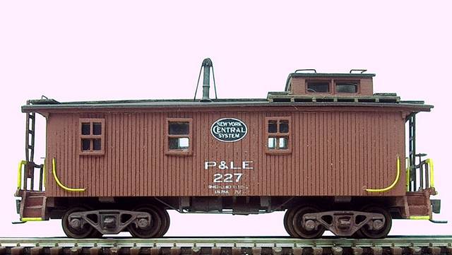

Be careful and check the decals before you use them. The PLE decals on the ones I did for a friend were PEL. I ended up making my own decals for the whole thing. Use the Atlas trucks, the kit is designed for them. MT trucks have an offset bolster hole which make them not line up properly.

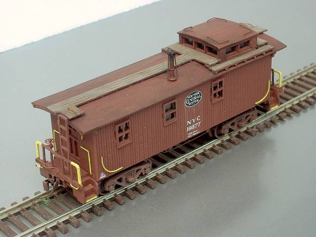

To answer your questions:
I used a yellow/brown carpenter's glue - Titebond III.  After trying lots of wood glues, it's the only one I'll use.
I was surprised, but they are not all the same.  Titebond III (not "II"... you want "III") is a lot stronger...
for benchwork too!
I used MT trucks with Fox Valley wheelsets in them, and body-mount couplers.
I used solvent-based paint (Floquil, I am pretty sure), and I painted it after it was all assembled, except that I
did paint the insides black before closing up the body.
I'm really sorry to hear that Robert isn't doing these anymore.  I have one built and another kit yet to build.
I guess between those two, and the MT "foobies" I have, that will have to do.
(or did you mean that he isn't doing the NYC ones, but maybe he is still doing the others?)
Mine ain't as nice as Tony's... but anyway...

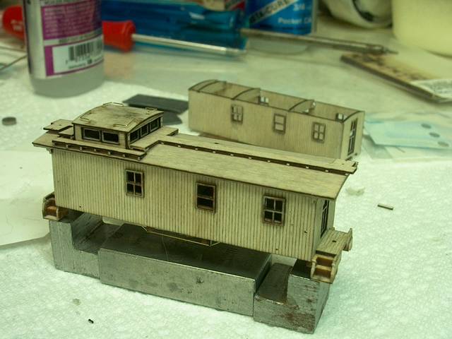

Here is my first one so far. About an hour into it.
I will try to take more pics as I progress..

I have a few step by step photos in my railimages album...
I used CA (super glue) to build for most of assembly. I'm just really comfortable with the stuff from many builds of RC planes. As you can see above, I painted it after assembly. I used Floquil Polyscale Boxcar Red and had no issues with warping.
The one thing I did do was pre-warp the roof before gluing it on. I soaked the roof sheet then taped it around a Microscale bottle to dry.
I also did not glue the body to the floor. It is held on with neodynium magnets to allow for adding more weight later or lighting if needed.
Good info on the prewarping the roof. I will have to remember that.
I am also using CA. I have built many RC planes (crashed them too) and have become pretty comfy with it and wood kits.  I also like the idea of magnets holding the body on instead of glue. Nice build shots and thanks for the info.
Here is my pretty much completed frame/undercarriage.
Only spent about a half hour on it tonight as I need to turn in early tonight.
