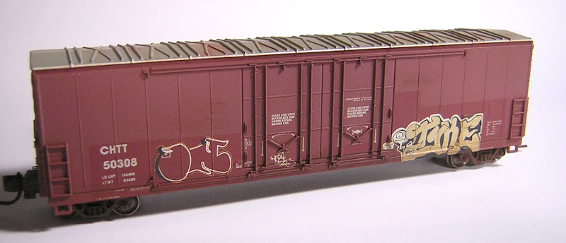

Ok, one more.  I really like the Evans double-plug cars:  CHTT prototype
http://www.rrpicturearchives.net/showPicture.aspx?id=225330
Atlas model:
This was mostly a test of paint-outs.  After a few coats of white/flat to seal the graf decals, I masked the paint-outs and proceeded to fully fade the remainder.  Now I'm running out of decent graffiti decals...
Thanks for looking - comments always welcome,
Gary

It's a very nice effect but the car ends up a bit washed out.  Maybe it's the lighting, but I think you could get the seams and rivets to stand out a little more.
Just a thought, looks great.

« Reply #19 on: October 22, 2008, 02:26:42 PM »
Yea, I think the grime wash went a bit too far on this car.  Next time I'll just try a very dilute raw umber to get a little definition on the seams but hopefully not obscure the pale blue too much (I am pretty happy with the initial fade though).  I'll keep this one in service - just not one of my favorites.
-gfh
