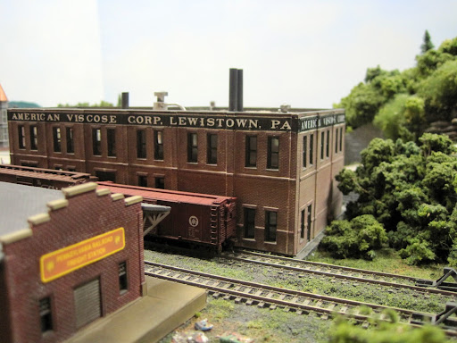

First, right in Lewistown is the American Viscose Co., which will be what I rename the structure serving as the "Juniata Machine Tool Company."

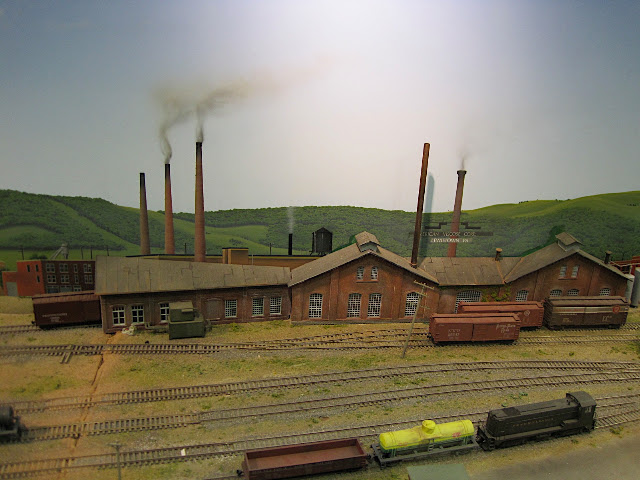

There were (and still are) TONS of rail-served mills and factories in Bellefonte, PA, which, while off the Middle Division, is still typical central PA.  Bellefonte's connection with the Middle Division was a Tyrone by way of the Bald Eagle Secondary.  While looking into what these industries might have been I found this picture of Bellefonte:
Which reminds me a little of this:
« Last Edit: October 03, 2010, 04:46:51 PM by Dave Vollmer »

« Reply #424 on: October 03, 2010, 05:09:12 PM »
Great comparison shot Dave...
Look at all the wires you see in the image of downtown Bellefonte.

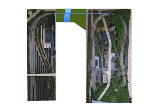

My approach would be to keep the current as is, but add a wye to one corner, or even break the loop, then use a second door, maybe 18" to 24" wide, to do a straight line main where you can stretch out the legs a bit, with Enola tied to the other end of that.
I'll have to tinker with some sketches, but I'm thinking an extended dogbone, basically a double track oval, but with the middle pinched together to make the 4 track main.  Use the Juniata Division as one end of the loop, keeping the two tracks, junctions etc.  With Enola at one end, it would be a point to loop, with a wye at one end of the JD, you could still have continuous running for show ops.
Re: Expanding the N Scale Juniata Division
« Reply #434 on: May 17, 2011, 03:07:05 PM »
I still think this idea has a lot of potential...
It wouldn't solve all of the problems at once, but I think it might provide a good interim step, one that can be explored at relatively low cost and effort (so it wouldn't be a big waste if it failed and got ditched); and it might lead to new ideas.
« Last Edit: May 17, 2011, 03:10:41 PM by David K. Smith »
